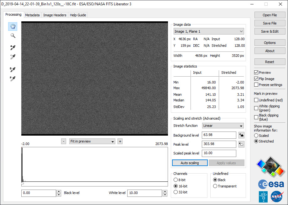

J'ai ce massage d'erreur Pix lorsque je tente de stacker mes darks - bien sûr mes images sont en 16bits.
Quelqu'un a déjà eu le pb ?

L'en-tête d'un des fichiers (FITS liberator 3) donne bien 16bits
Image #1
SIMPLE = T / file does conform to FITS standard
BITPIX = 16 / number of bits per data pixel
NAXIS = 2 / number of data axes
NAXIS1 = 4656 / length of data axis 1
NAXIS2 = 3520 / length of data axis 2
EXTEND = T / FITS dataset may contain extensions
COMMENT FITS (Flexible Image Transport System) format is defined in 'Astronomy
COMMENT and Astrophysics', volume 376, page 359; bibcode: 2001A&A...376..359H
BZERO = 32768 / offset data range to that of unsigned short
BSCALE = 1 / default scaling factor
INSTRUME= 'ASI 1600mm Pro' / The model Camera used
DATE-OBS= '2019-04-14T19:59:36' / The UTC date and time at the start of the expo
HIERARCH CAMERA-DATE-OBS = '2019-04-14T19:59:36' / The UTC date and time at the
EXPTIME = 120. / The total exposure time in seconds
CCD-TEMP= -18. / Temperature of CCD when exposure taken
XPIXSZ = 3.8 / Pixel width in microns (after binning)
YPIXSZ = 3.8 / Pixel height in microns (after binning)
XBINNING= 1 / Binning factor in width
YBINNING= 1 / Binning factor in height
XORGSUBF= 0 / Sub frame X position
YORGSUBF= 0 / Sub frame Y position
EGAIN = 4.96000003814697 / Electronic gain in e-/ADU
FOCALLEN= 800 / Focal Length of the Telescope in mm
JD = 2458588.33449074 / Julian Date
SWCREATE= 'Astro Photography Tool - APT v.3.63' / Imaging software
SBSTDVER= 'SBFITSEXT Version 1.0' / Standard version
SNAPSHOT= 1 / Number of images combined
SET-TEMP= -20. / The setpoint of the cooling in C
IMAGETYP= 'Dark Frame' / The type of image
SITELAT = '+43 41 16.612' / The site Latitude
SITELONG= '+03 47 49.349' / The site Longitude
GAIN = 0 / The gain set (if supported)
